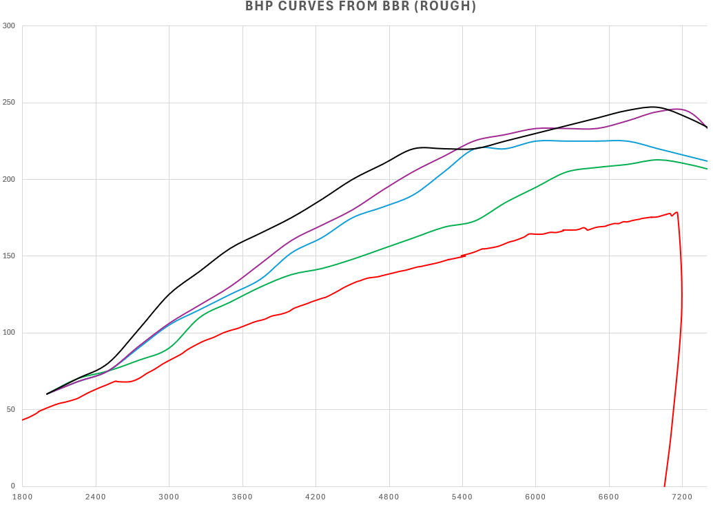

While im looking ahead for future mods i was trying to compare the BBR packages side by side. not easy to do on their website.
so i lifted the values off in 250rpm intervals to overlay them on a BHP power curve.

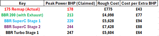

then decided to break down the £’s spent per horse on each of the packages.
I havent done torque, as i think it would get to messy.
*note the ‘baseline’ on this is my ecu dyno output from the 175 map, so gives that as a base curve. however the cost per horse is based off a 160bhp starting point.
all data taken from BBR’s site of course.
Hope someone finds this useful when looking at future upgrades :smiley:
Your BBR 200 figure (£2,874) excludes fitting and does not include the exhaust.
If you’re taking it from BBR MX-5 ND Super 200 – BBR GTi, the exhaust adds:
The addition of a 2.5 inch diameter high performance TIG welded stainless steel exhaust centre section (£495.00) allied to stainless steel 2.5 inch BBR silencers (£395.00) boosts peak power to 214 bhp and torque to a mighty 183 lb.ft
A fitted price is:
the Super 200 is available at £2795+VAT fitted (including dyno testing.)
I didn’t check the others; it was just that having had Super 200 and an exhaust fitted to my car your figure struck me as too low.
ah yea i forgot to add that in. i just took the face value ‘package’ numbers.
added in their suggested center section and backbox (which is showing as £1224 combined in the basket).
thanks for the spot, original post edited to reflect.

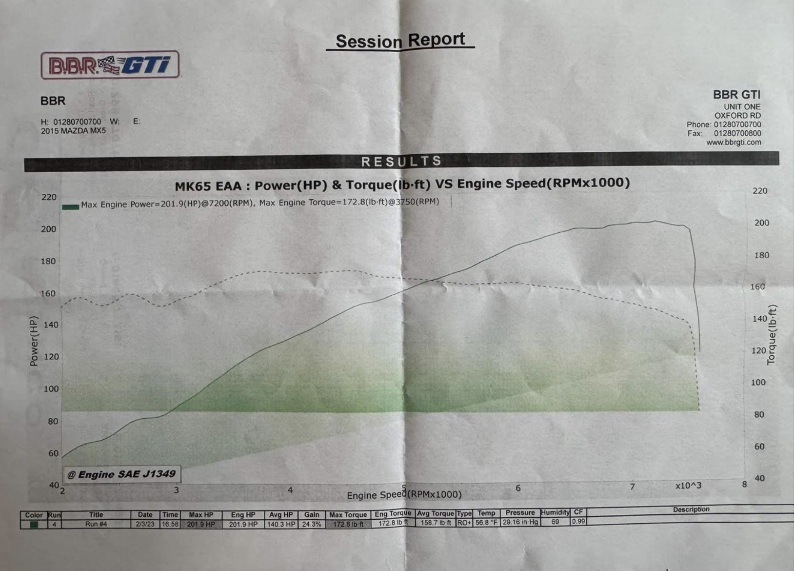

The current BBR manifold for the Super 200 (post ND2 introduction) doesn’t yield as much power, but more torque. About 202-205 bhp with full exhaust. BBR aren’t that forthcoming about this on their website, and it can lead to some (on-paper at least) disappointment. Drives brilliantly through.
Yes, that’s my setup and it made 200.3hp @ 7050rpm. Neil confirmed it was due to the manifold redesign for the ND2.

My dyno report is at the end of the thread.
My dyno below. 2015 Sport Nav with Super 200 (catted manifold, midpipe and GT back box) fitted in 2023.
